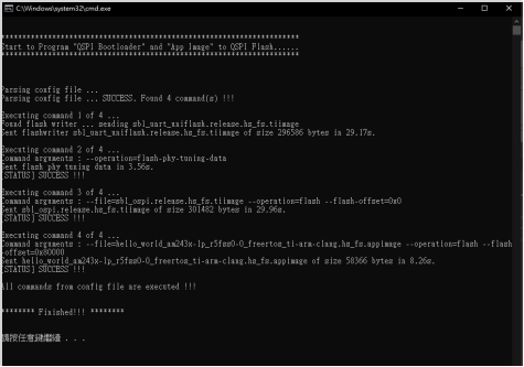

    My customer just got HS-FS device. They are trying to program it on their board.  They are using following configuration file to program it.
Basically, just replace prebuilt GP images to prebuilt HS-FS images for flash writer, sbl_ospi.
The hs-fs image for hello world is recompiled from CCS and generate automatically by default makefile_ccs_bootimage_gen.
ospi_sbl_app.cfg
You can see they can program device successfully.  However, reboot device, the device doesn't work and they can't get anything output from UART.
The same situation when they change to program sbl_null. Device can be programmed but boot fail.
Field FAE doesn't have HS-FS EVM, can you please help? Anything missing in their steps?

    C:\ti\mcu_plus_sdk_am243x_08_05_00_24\tools\boot>python uart_uniflash.py -p COM13  --cfg=sbl_prebuilt/am243x-lp/default_sbl_ospi_hs_fs.cfg
    Parsing config file ...
    Parsing config file ... SUCCESS. Found 4 command(s) !!!
    Executing command 1 of 4 ...
    Found flash writer ... sending sbl_prebuilt/am243x-lp/sbl_uart_uniflash.release.hs_fs.tiimage
    Sent flashwriter sbl_prebuilt/am243x-lp/sbl_uart_uniflash.release.hs_fs.tiimage of size 296586 bytes in 26.62s.
    Executing command 2 of 4 ...
    Command arguments : --operation=flash-phy-tuning-data
    Sent flash phy tuning data in 1.6s.
    [STATUS] SUCCESS !!!
    Executing command 3 of 4 ...
    Command arguments : --file=sbl_prebuilt/am243x-lp/sbl_ospi.release.hs_fs.tiimage --operation=flash --flash-offset=0x0
    Sent sbl_prebuilt/am243x-lp/sbl_ospi.release.hs_fs.tiimage of size 301482 bytes in 29.78s.
    Executing command 4 of 4 ...
    Command arguments : --file=../../examples/drivers/ipc/ipc_notify_echo/am243x-lp/system_freertos_nortos/ipc_notify_echo_system.release.appimage.hs_fs --operation=flash --flash-offset=0x80000
    Sending ../../examples/drivers/ipc/ipc_notify_echo/am243x-lp/system_freertos_nortos/ipc_notify_echo_system.release.appimage.hs_fs: 119364bytes [00:1Sending ../../examples/drivers/ipc/ipc_notify_echo/am243x-lp/system_freertos_nortos/ipc_notify_echo_system.release.appimage.hs_fs: 119364bytes [00:1Sending ../../examples/drivers/ipc/ipc_notify_echo/am243x-lp/system_freertos_nortos/ipc_notify_echo_system.release.appimage.hs_fs: 120393bytes [00:1Sending ../../examples/drivers/ipc/ipc_notify_echo/am243x-lp/system_freertos_nortos/ipc_notify_echo_system.release.appimage.hs_fs: 120394bytes [00:1Sending ../../examples/drivers/ipc/ipc_notify_echo/am243x-lp/system_freertos_nortos/ipc_notify_echo_system.release.appimage.hs_fs: 120395bytes [00:1Sending ../../examples/drivers/ipc/ipc_notify_echo/am243x-lp/system_freertos_nortos/ipc_notify_echo_system.release.appimage.hs_fs: 120396bytes [00:1Sending ../../examples/drivers/ipc/ipc_notify_echo/am243x-lp/system_freertos_nortos/ipc_notify_echo_system.release.appimage.hs_fs: 120397bytes [00:1                                                                                                                                                    Sent ../../examples/drivers/ipc/ipc_notify_echo/am243x-lp/system_freertos_nortos/ipc_notify_echo_system.release.appimage.hs_fs of size 118936 bytes in 13.61s.
    All commands from config file are executed !!!
    HOWEVER, the device can't boot. There is no message from UART.  Any suggestion?

  •   Aakash,
            Customer confirm this issue happens on both GP & HS-FS device with SDK8.5.
    After changing QE bit enable type from "0" to "5" in syscfg, this problem can be solved. Thanks for your help.
    Andre
