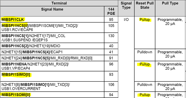

    However, I still have questions about the electrical compatibility of the Micro SDXC High Endurance with the RM46L852. According to Jaggadish and his team, there should be no problem as long as the SPI protocol is complied with, that is, in the communication aspect, compatibility is ensured. However, the Sandisk company told me to ask Texas Instrument not only about this aspect but also about the characteristics related to the interference that SPI signals may suffer if the RM46L852 microcontroller is used, as well as the values of the resistors. pull-up and pull-down you must arrange the pins of the SD. This aspect is very important since the SD specification recommends a minimum value for pull resistors of 10 Kohm.
    However, due to the pull characteristics that the microcontroller has when it is in the Reset state during power-up, it acts as a current source with a value of 20 uA or 100 uA and has a different pull configuration during the reset state than the one desired. So, if a pin is pulled-down in the reset state and I need it to be pulled-up, then if I use an external 10 kohm resistor, the voltage on the pin will not be "0" (resistance pull-down resistor) but will be 3.1V due to the external pull-up resistor when the microcontroller is in reset state. For this reason, I am using a 4.7 Kohm pull-up resistor to get a voltage of 3.2 V (closer to 3.3 V). Any other considerations in the circuit such as capacitors?
    Francisco.
  • HI Francisco,
    RM46Lx device has internal pull for SPI pins. The pull-type is configurable, and default is pull-up. I think the internal pull-up is sufficient for interfacing with SD card.
  • Hello QJ,
    I asked to texas instrument support if it was possible to configure the internal pull resistor when the device was in the RESET state, they told me it was not possible. Once it leaves this state, and enters the initialization state, it is possible to configure it, but while it is in the RESET state, it will have a fixed value of the internal pull resistors. For this reason, I need to use external pull resistor.
  • Hi Francisco,
    If you use MibSPI1/3/5, the SPI signals (CLK, CS0, MOSI, SIMO) are internally pulled up:
  • Hello QJ Wang,
    I can't use these pins because I also use the Ethernet module. However, this information is essential if in a future I use the RM46L852CZWTT, thank you.
    Regarding the subject of the resistors to be used, I could say that this topic is finished. However, I need to ask you what other features of my circuit I should consider in order to use continuous monitoring of the micro-SDXC in an industrial environment.
