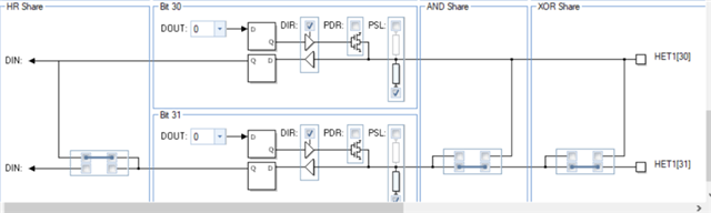

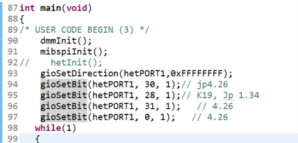

I set N2HET1_30 pin as output and use gioSetBit() function to enable pin but there was no voltage output.
The HALcogen set as below:
with testing code:

It is working fine at my end, i am attaching my code for your reference. Please go through it once.

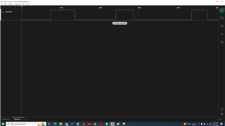

Here i set break points for SET and CLEAR values, and i verified the logic states through logic analyzer
I can see the output voltage.
