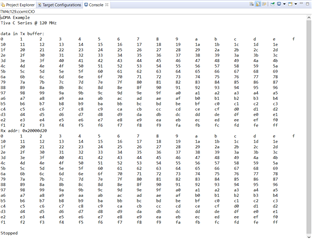

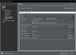

Hi Community,
when i try to debug my code using ICDI in
Code Composer Studio
Version: 12.1.0.00007
i'm first time i got error as follows
CORTEX_M4_0: Trouble reading Memory Block at 0x40009008 on Page 0 of Length 0x04: Debug Port Error occurred.
the above error occurred for 2 time then get solve automatically after few hours i debugged previously older code it was working fine then
next day i get
CORTEX_M4_0: File Loader: Verification failed: Values at address 0x0000000000000000 do not match Please verify target memory and memory map.
This error got solved after some time. after that i tried to debug, i'm able to debug for few times like 3-4 time.
when I trying to debug code after all the above errors even i used JTAG following error occurs every time i try to debug
CORTEX_M4_0: Error connecting to the target.
i'm able to detect the device in device manager in Windows 10.

Previously i was able to debug the other code for the heap size: 0x800 and stack size : 1024, before occurrence of those errors as mentioned above.
after debugging the below code only i'm facing issue.

    - BTW, I run your code as is and I don't have a problem. Here is what I see on the console after running it. I use 0x800 as heap like yours.

  • I tried with custom board which has TM4C129ENCPDT (same IC is soldered on board) tried with "Device UART communication" on it instead of ICDI.
    - I'm not clear what you meant by "Device UART communication" instead of ICDI? On your custom board, don't you have a JTAG connector that you can connect with an external debug probe?
    - Show me a screenshot that you select "Device UART communication". I'm very confused what you are trying to do. If you are trying to load your firmware through UART, then you are running a UART bootloader. Is that what you are doing? Until you can explain your setup, I'm not sure how to help.
    - What flash programmer do you use to load the code? Uniflash or CCS or LM flash programmer? Note, you cannot use LM flash programmer for your customer board. LM flash programmer only supports ICDI.
    - What debug probe do you use to connect to the custom board?
  • Hi Charles Tsai,
    what i mean to say was i have custom board which is designed based on Tiva board.
    custom board not configured for UART bootloader
    CCS
    No debug Probe used it was just UART port
    give some time to explore more on it.
