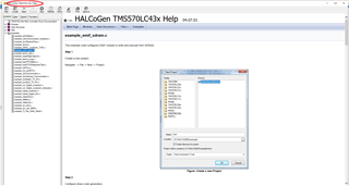

I want to interface SDRAM(IS42S16400J-7BL) to TMS570LS3137 in HDK Hercules TMS570LS31x/21x Development Kit.
In Halcogen, this the configuration I made
   Enable EMIF driver in Deiver enable Tap
  Pinmux tap Checked the EMIF and Checked EMIF_CLK output in Special Muxing Option

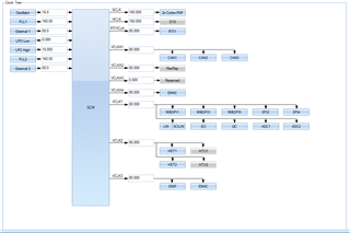

   VCLK3 is 80MHZ
   EMIF tap, EMIF SDRAM tap
  trfc = 63ns
 trp= 20ns
trcd = 20ns
twr =15ns
tras = 42ns
trc = 63ns
trrd =14ns
txsr = 70 ns
Refresh Period = 64ms
Refresh Cycles = 4096
CAS =2
Banks = 4
Page Size = 256
SDRAM init = 200us
Generated the code and in Main function called this two functions
muxInit();
emif_SDRAM_StartupInit();
After I try to write on location 0x88000004 but can't access the location Please Help Me
Thank you.
