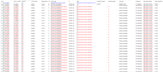

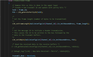

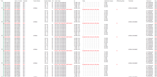

Dear TI experts,
I am sending a schedule table which has 10 frames with combination of Published and Subscribed frames.
I am able send subscribed frame but after that if published frame is sent I get a error.
Should I clear any register after sending a subscribed frame ?
** Note: I am commenting //LIN_sendData(APP_LIN_BASE_ADDR, txData1); for SUBSCRIBED frames because data will be filled by slave device.
I have attached the driver code below:

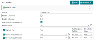

  • Hi ,
    Are you using LIN example from the Interrupt mode or the Polling mode ?
    Aakash

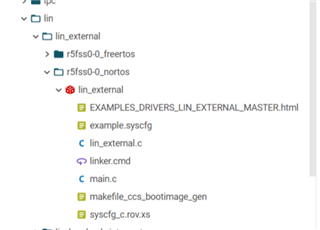

  • Hi Aakash, I am using LIN External Example code, In this there is no loopback mode set:

  • Hi  Yes you can use same lin external example syscfg, Only change is they are sending only subscribed frame in the example code and waiting for rxdata. You need to send rxframe (Subscribed) and txframe(Published) in a while loop with some delay. You should be able to reproduce that scenario.
    If you are using the above code with linexternal syscfg then no need of any change, you should be able to reproduce the issue.
    I have attached some evidences of Published frames not sent after Subscribed frame sent below:
    **Note: https://e2e.ti.com/support/microcontrollers/arm-based-microcontrollers-group/arm-based-microcontrollers/f/arm-based-microcontrollers-forum/1189452/mcu-plus-sdk-am263x-lin-sdk-function-is-setting-a-improper-register-bit-for-selecting-the-checksum-type-in-the-register
    You may get wrong checksum until the above SDK bug is fixed but you should be able to reproduce the issue by commenting //LIN_setChecksumType(APP_LIN_BASE_ADDR, LIN_CHECKSUM_ENHANCED); and using  HW_WR_FIELD32_RAW((APP_LIN_BASE_ADDR + CSL_LIN_SCIGCR1), CSL_LIN_SCIGCR1_CTYPE_MASK, CSL_LIN_SCIGCR1_CTYPE_SHIFT, LIN_CHECKSUM_ENHANCED);

    My problem is I am developing software for LIN Master.
    After I send a header and wait for slave to respond after that I am not able to send a header even after 100ms of actual slave response.
    In the attached project you can also see the Lin Trace files attached with complete project code.
    Please flash the above project i have shared in google link and watch the output in any analyser you shall see the header for frame id 0x22 is not getting transmitted after frame id 0x27 has been responded by the simulated slave.

    I have also captured the logic analyser logs of the LinBus for capturing the exact errors.
    https://drive.google.com/file/d/1PRtDRHnIRsAVeWsOL5IeuaAKFJ2HfHPj/view?usp=sharing
    Please find the snap for frame Id 0x27 which is responded by the simulated slave from the Canalyser configuration.
    Below are the signals transmitted by AM2634 instead of frame  0x22(Header and data to be transmitted by AM263x)

    To determine, if the packet is supposed to be received or transmitted, that id filter needs to be updated in the filter mask.
    Hence, in case of transmit, you need to call -
    txID = LIN_generateParityID(txID);
    LIN_setTxMask(APP_LIN_BASE_ADDR, txID);
    In case of receive -
    rxID = LIN_generateParityID(rxID);
    LIN_setRxMask(APP_LIN_BASE_ADDR, rxID);
    We tested the same and we don't see the packet drop anymore.
