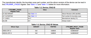

I am currently trying to evaluate in Code which processor variant the code is running on. Especially if it is a HS or GP device.
We already did something similar in the past with the following register which is not documented in the TRM but is found in "bootloader_soc.c".
#define BOOTLOADER_SYS_STATUS_REG              (0x44234100U)
In uint32_t Bootloader_socIsAuthRequired(void) the following code is used to identify if the current processor is a HS or GP device:
uint32_t devType    = CSL_REG32_RD(BOOTLOADER_SYS_STATUS_REG) & BOOTLOADER_SYS_STATUS_DEV_TYPE_MASK;
    uint32_t devSubtype = CSL_REG32_RD(BOOTLOADER_SYS_STATUS_REG) & BOOTLOADER_SYS_STATUS_DEV_SUBTYPE_MASK;
    if((devType == BOOTLOADER_SYS_STATUS_DEV_TYPE_GP)   ||
       (devType == BOOTLOADER_SYS_STATUS_DEV_TYPE_TEST) ||
       (devSubtype == BOOTLOADER_SYS_STATUS_DEV_SUBTYPE_FS))
Today I stumpled across this other register which is documented in the TRM:
Can we also use the SECURITY bit to identify if a device is a HS device? Is this redundant to the other register which is not documented in the TRM?
Fabian
EDIT:
Also the Silicon Revision would be nice to know: I found JTAG_ID in the TRM
But this only describes SR 1.0. There should be already a SR2.0 (the current silicon revision)?!
