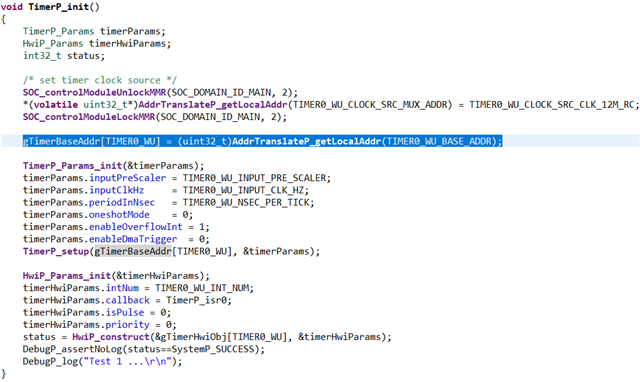

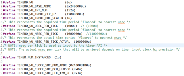

1) The timer is set and interrupts are turned on, but interrupts cannot be triggered. The program is as follows, is it just required to initialize and TimerP_start(gTimerBaseAddr[TIMER0_WU])?
