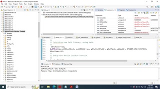

  • Attaching a screenshot to understand the issue better
    I am updating dbnctimer before and after lwip. Last update to dbnctimer is 11.  Actually after lwip it will be loaded with 12 and beyond that it continuously incremented.  But it stuck at lwip and did not change in debugger.

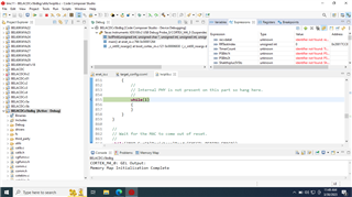

    We single stepped through and the code stuck at  a while loop inside LWIPinit
    • if(MAP_SysCtlPeripheralPresent(SYSCTL_PERIPH_EPHY0))
      // Yes - enable and reset it.
      MAP_SysCtlPeripheralEnable(SYSCTL_PERIPH_EPHY0);
      MAP_SysCtlPeripheralReset(SYSCTL_PERIPH_EPHY0);
      else
      // Internal PHY is not present on this part so hang here.
      while(1)
    Attaching the screen shot

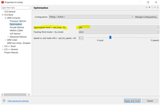

  • This is a different problem.  I usually do not single step.  1st time I single stepped to  see a strange behavior in CCS.  The execution goes up and down for some reason.  Attaching the video.
  • attaching the video
      The reason that it goes up and down is because you have optimization turned on. Normally by default the optimization is set to 2. I usually turn off the optimization during software development like below. It will be easier to debug the code such as single stepping so the code will not jump around. Once the firmware development is complete, I will then turn on the optimization for final release.

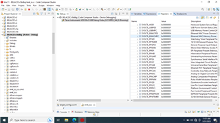

      One more thing to debug your issue.

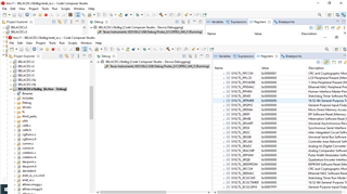

    - Take a screenshot of your System module registers. I want to see if the all the Ethernet related components are present. Below is what I see on the LaunchPad highlighted in yellow. Can you show the settings of the registers on your non working boards and your working boards. Are there differences between them?

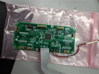

  • Please also take pictures of the chips that has have issues during lwIPInit() where it is stuck due to PHY not present. I want to read the marking on the chip. Please do so as well for the working boards so we can investigate and compare.
  • Screenshot of system module registers and picture of chip attached
  • The print on the IC is not very clear after the IC is assembled and cleaned with IPA solution.  So I took the picture of IC before assembly
    We have assembled around 3 boards  and all have same issue.
    Today I read the Device Identification 1 (DID1) register from the MCU and it read as 0x1019C06E in the faulty board.  The partno. is 0x19 .
    I read the same register in evaluation board and DID1 is 0x101FC06E and part number is 0x1F.  TM4c1294ncpdt data sheet it is mentioned as 0x1F only.  I am not sure which is part number 0x19?
    I feel the print on the MCU seems to be wrong!  Can you  confirm?
