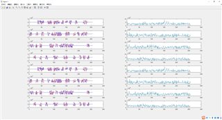

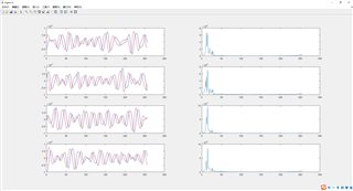

  • Hi Cesar,
     The emulation looks at CSIA_PingBuf, CSIA_PongBuf, CSIB_PingBuf, CSIB_PongBuf and CSIB_PongBuf and the data is correct.
    But the data sent via LVDS is wrong, I would like to know why this is happening and how to fix it, it looks like the data sent by LVDS is not the data I see in the emulation.The image on the left is received by LVDS, the image on the right is data from L3 memory
    Unfortunately it is difficult to provide feedback since your hardware is different.
    We are only able to support hardware based on the schematics we provide
    thank you
    Cesar
