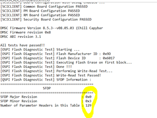

When I run the flash_diag example from SDK 8.5. the app prints out dev. and man. ID just fine and also does correct read-write test. However when continuing to read SFDP goes wrong
and the data seems to be corrupted.
Here is output of the app.
From what I understood the flash_diag should work on any flash that support SFDP. What could be the cause of this ?

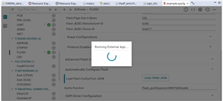

  • Also one more question. When trying to import example JSON to try out on the Launchpad, the sysconfig doesnt load anything and
    is tuck in loop on this frame.
    Do you know what could be causing this Issue ?

  • Hi ,
    I understand the problem and apologies for the inconvenience but we need to do a deep dive analysis for the same. For now, my suggestion would be to comment the flash open function created by the driver and write a new function of flash open (which refers to the functional code based on previous SDK) and then call out that function.This will surely help you.
    The syscfg you might need to mention the flash sizes. My suggestion would be to fill this data manually if you are facing this issue via *.json.
    Aakash
