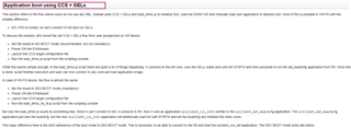

    Please follow the migration from GP to HS-FS devices - https://software-dl.ti.com/mcu-plus-sdk/esd/AM243X/latest/exports/docs/api_guide_am243x/HSFS_MIGRATION_GUIDE.html
    It mentions that the device should be in DEV_BOOT_MODE. For LP device of AM243x, the NO_BOOT_MODE and DEV_BOOT_MODE settings are same.
    Refer this part -
    This will help you initialize the device (in dev boot mode with initializations done via CCS/sciclient_ccs_init).
    Hope this helps.
    Aakash
  • Aakash,
       Device is set to no-boot/dev boot mode already. I review the document you provide, I don't see any different steps. The processes follow the step:
    In case of HS-FS device, the flow is almost the same:
    • Set the board in DEV-BOOT mode (mandatory)
    • Power ON the EVM/board
    • Launch the CCS target configuration file
    • Run the load_dmsc_hs_fs.js script from the scripting console.

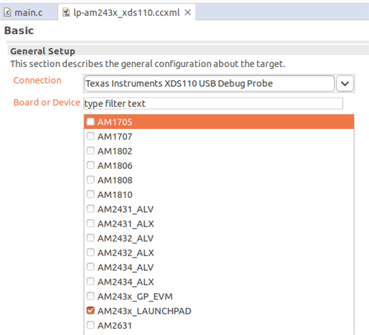

  • Aakash,
       Target configuration is set to AM243x_LAUNCHPAD. I use default configuration.
    Target configuration file is  attached lp-am243x_xds110.ccxml
    https://e2e.ti.com/cfs-file/__key/communityserver-discussions-components-files/908/lp_2D00_am243x_5F00_xds110.ccxml
    Andre

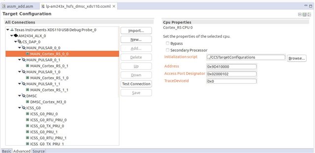

  • Hi ,
    The load_dmsc_hsfs.js loads the sciclient example which loads the system firmware -
    MCU_PLUS_SDK/examples/drivers/sciclient/sciclient_ccs_init/am243x-evm/r5fss0-0_nortos/main.c
    In your target configurations, please make sure none of the GEL files are loaded -
    Hope it helps.
    Aakash
  • Aakash.
       In \target configurations, none of the GEL files are loaded - The suggestion doesn't help.
     https://e2e.ti.com/cfs-file/__key/communityserver-discussions-components-files/908/lp_2D00_am243x_5F00_hsfs_5F00_dmsc_5F00_xds110.ccxml
