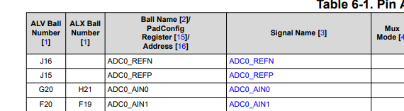

Team,
When using Ultra Librarian to get the symbol for AM2432B (Rev 2.0), it seems that a symbol for silcon rev 1.0 is generated. J15 and J16 are shown as VDDS_MMC0 and VSS, not ADC0_REFP and REFN.
How can this be fixed?
Robert

Hi Zackary,
Looks like these are also wrong, can you please check?
Robert
I will need to audit the full pin list on these devices - not just the pins that have been specifically called out. The process will likely take over a week to get refreshed on the ti.com site once the changes are in place. We are already in contact with the librarian team. Will update this thread as updates are made.
Thank you,
-Randy
