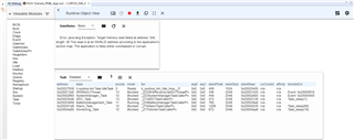

    The ROV task view shows which task is running - which should usually be the Idle task. You might catch another task running, but if you keep refreshing, it should usually be idle running. Use the Detailed view option to check no task has exceeded its stack size. Can you post an image of the ROV task view?
    If you suspend execution from the debug menu, you will see if the processor has jumped to the exception handler - it will be on a line with the comment "loop here forever". This is usually because of task stack overflow, or some other assert or null pointer de-reference.
  • Hi Jim,
    I tried to do all the steps which you mentioned.
    I runed the code and in ROV task view made it to display detailed view. Please find the attached image below.
    The code got stuck and suspended execution , i can see the processor jumped to exception handler. It was bus Fault. Please find the attached image below.
    Now I pressed step-in and code jumped to queue. Please find the attached image below.
    Now again I pressed step-in. I think The code is in loop forever because it again jump to exception handler and then to queue.
  • It is a little hard to see what is happening without all of the code but we can see that it appears to get stuck in the BatteryManagement_task which the ROV shows as running.
    It appears to be having a bus fault from within the Mutex code - perhaps a pointer is not set correctly so trying to address thin air!

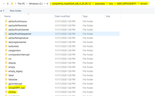

    What if you call I2C_transfer instead of I2C_transferTimeout? Does it make a difference?
    There are some examples in the I2C.h File Reference guide. file:///C:/ti/simplelink_msp432e4_sdk_4_20_00_12/docs/tidrivers/doxygen/html/_i2_c_8h.html. Can you take a look?
     There are 2 more examples at below locations. Can  you take a look?
