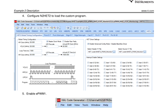

Part Number: TMS570LC4357
in Application Report SPNA178 – April 2015
Example 2, there are instructions use IRQ=ON, like
But N2HET settings are
Isn't it required to setup Interrupt Enable Settings for corresponding addr ?
Hi Hongbo,
Please refer below thread which explains configuration procedure for interrupt in HET IDE code
Thanks & regards,
Jagadish.
