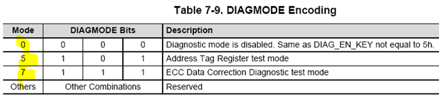

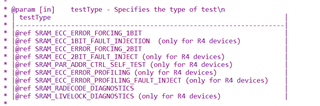

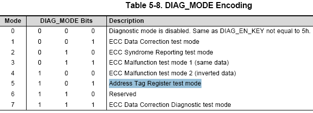

We need to use the TI diagnostic library to test RM57L843 chip, but the diagnostic library provides few test items compared to R4F devices.
Why is this? Don't R5F devices require so much software test? Thanks.

SRAM_ECC_ERROR_FORCING_1BIT (used for R5 or R4) and SRAM_ECC_1BIT_FAULT_INJECTION (used for R4) are the same test.
and
SRAM_ECC_ERROR_FORCING_2BIT (used for R5 or R4) and SRAM_ECC_2BIT_FAULT_INJECT (used for R4) are the same test too.
