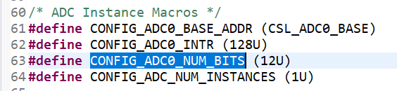

We found that AM243x-ALX only ADC10Bit. But when we look into the SDK ADC example based on LP-AM243X, all parameter calculations are set with 12 bits.
Is this correct? If yes, Is there any calibration or conversion done inside AM243x-ALX? If it is used normally, should I calculate by 10 Bit or 12 Bit?

I got the information from the HW Team.
For this you can use the same calculation for 12-bit.
Since ALX didn't have the pins available to support ADC_VREFHI and ADC_VREFLO, it is unable to meet the spec for 12-bit precision, but it's still the same 12-bit IP, so all calculations remain the same and they just get truncated 10-bits from 12-bit result.
You can test it at your end, by giving a constant 3.3V input to ADC Pin and see the debug prints.
