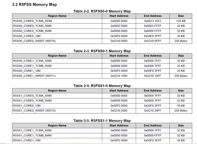

I'm just trying to search the ROM bootloader base address location in the memory map and I'm not able to core relate the below core memory map.
Hi Team,
Hi Karthikeyan
The above memory addresses you have are for TCM memory locations.
For information about ROM sequence please refer to section 5.2 Boot Process in TRM.
For More information on ROM Address (as part of Security package by TI) and HSM related info, please reach out to your FAE for signing the security NDA.
Please find the link for the above here:
https://www.ti.com/product/AM2634#product-details
