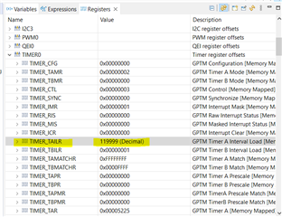

    sorry, that was not my point (by the way, in my humble opinion, with MSP432E indexing starts at 0, so Timer0 and Timer1).
    Ok, you may be right. I just open a CCS register browser window while running a very basic MSP432E RTOS example and Timer0 module is used for generating RTOS ticks. The timer load value is about 120000 which is 1ms by default.
