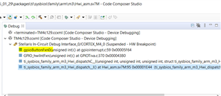

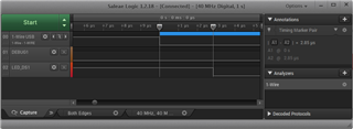

I'm using the gpiointerrupt example from the drivers example. I'm seeing a delay of the callback in the microseconds. I didn't expect to see so much latency. Is there some way to fix this?

Hi Mike,
