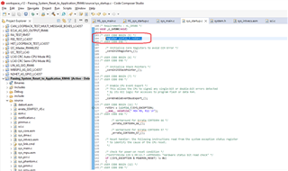

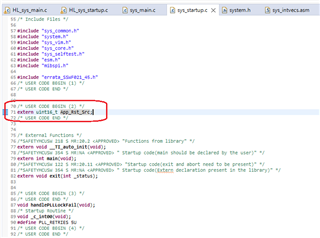

    After analyzing code i found below working method to preserve the reset source

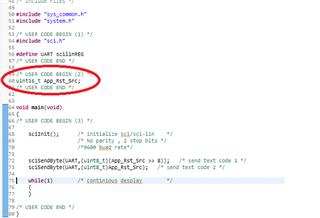

    1. First i declared one variable in main.c called "App_Rst_Src" which will give reset source value to the application,
    2. I extern this variable into the startup.c

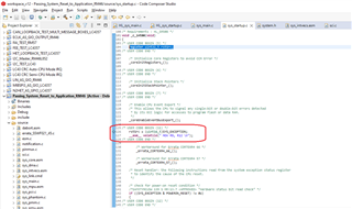

    3. Now i declare another variable with register type in _c_int00 function, this register type variable is required because normal global variables will get initialized in the memory initialization functions but if we declare it as a register then variable value stored in register, so value won't get lost.
    4. Actually, what i want to do is, i just want to copy the SYS_EXCEPTION value into this register variable first and again i want to copy this register value into the "App_Rst_Src" before i exit to the main function.
    But i faced one problem in doing this process, that is the register allocated for the rstSrc variable is again using in some assembly program, so again the above method failing. So, i did little modification for above method i.e. after copying into the register variable i just also want to copy it to the another register which is not used by later program, so that my value get preserve and after that i want to move it into the final application variable called App_Rst_Src.

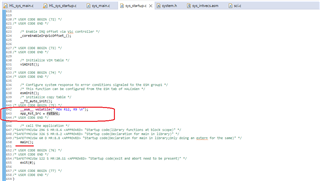

    5. I copied the SYS_EXCEPTION  into the register variable called rstSrc which is using R12 register here, but as i told you this register is using later assembly program so i again copied that R12 value into R9 which is not using in the assembly program.
    6. And before calling the main function i am copying that R9 register value to the R12 which is rstSrc variable and from this variable i am copying to our main application variable called App_Rst_Src
    7. In Main function i am printing this variable value
    I am attaching my example project here please go through it
    Passing_System_Reset_to_Application_RM46.zip
    Startup code fixed right so there is no chance of this R9 register will affect in the future and also i tried with different optimization levels and still code is working properly. I hope this project would be helpful.

  • Good news: the R9 strategy seems to be working!

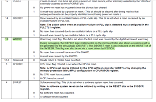

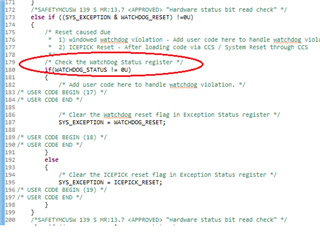

  • Hi Gabriel,
    Do you also have the watchdog set at all times?
    Actually, it is not due to watchdog reset, if we see TRM
    It is due to ICEPICK reset caused due to debugging.
    In code also, if watchdog reset flag set then they are again verifying WATCHDOG_STATUS register to confirm whether it is really due to watchdog or not. If it is not due to watchdog then they are confirming this reset cause as ICEPICK_RESET.

  • It looks like it's working!
    Using WATCHDOG_STATUS we can differentiate between watchdog and jtag reset.
