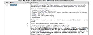

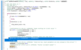

    2. While reading data make sure you are polling the RXINTFLG flag
    If we didn't wait till RXINTFLG to read data then in debug it might work due to breakpoints but when we flash it will not work.
    Like as highlighted in below function
    If still issue exists, please share your screen to verify at my end once.
