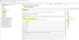

    In the .cfg file you can insert you own Idle function as follows.

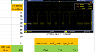

  • Hi charles,
    i checked cpuload with GPIO.
    i made one idle task like this
    void idleTask (void)
              while(1)
                     GPIOPinWrite -> high
                      Task_sleep(100);
    over 1sec time frame i got cpu load as 50%
    but when i checked in ccs the cpu load graph is showing 100%
    This is unexpected. Can you help me in debugging the ccs tool issue.This graph is showing wrong result.
      Is the CPU load shown on CCS over one second?  Will you be able to zoom out for a larger time span? What are the user tasks and how many tasks are you running?

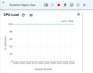

  • Hi charles,
    The above pic is not of 1sec, but I kept for longer run and observed the graph for 15 minutes. It is continuously showing 100%.
    Total 6 user task are running other than idle task.

      Before I send your question to our CCS expert, I will suggest one more experiment. How are you resetting the GPIO right now? Is it only in the highest task? Can you try to clear GPIO pin in all of your tasks. Anytime when idle task is entered, the GPIO pin is asserted but whenever it is switched out to any other non-idle task it will clear GPIO pin.
      From CCS perspective, I don't know how does it know which task is a idle task and which is a non-idle task. If CCS is treating your user-defined idle task as a regular task then it may explain why CPU load is 100%. If this is the case then using user-defined idle task with pin toggle is not the correct method. But I will defer that question to CCS experts for comments.

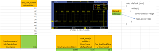

  • Hi charles,
    As you asked to reset the GPIO in all of the user task. I did that and attaching the results below.
    in the idle task
              while(1)
                      Task_sleep(100);
    I modified the task_sleep as 100 , 200 and 250 and attaching the results below.
    idle_task--> modify task_sleep to 200
    idle_task --> modify task_sleep to 250
    I dont know when i check cpu_load using ccs tool under ROV how it is calculating , is there any place where i can see the settings ?
      Independent of what ROV shows, please bear in mind that task_sleep() is in terms of system ticks. By default a tick is 1ms. When you put task_sleep(250) in your user-defined idle task,  it will first set the GPIO pin and then put the task into a BLOCKING state for 250mS. While the user-defined task is in blocking state, I'm pretty sure your other 6 normal tasks are running according to how the events (e.g. semaphore or others) triggering each other to run. This is why you are showing 99% CPU load.  Perhaps a more accurate way is to remove the task_sleep. After the user-defined idle task, it just sets the pin. If there are no other tasks to be run, the kernel should call other idle tasks (see below) until your normal tasks resume running upon which the GPIO pin is cleared again.

  • Hi, thanku for suggesting this experiment, The idle task was running most of the time. This boost my confidence that cpu load is not 100% which is getting reflected on CCS. Can you please forward my question to any CCS expert.

    I have followed this method and found cpu load is not 100% as displayed in ccs under rov.
  • I have followed this method and found cpu load is not 100% as displayed in ccs under rov.
    I'm not sure I understand. After following this method, CPU load under ROV is now not 100% anymore?
    I did that experiment with help of GPIO and measured cpu load. If i see CPU Load under ROV it is still 100%.
