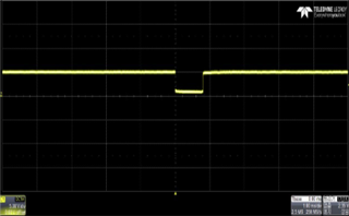

When using two, there is a change in waveform (HIGH -> LOW -> HIGH) as shown below at the INT pin of the device without changing the value of IN0 to IN23.
If only one is used, the value of HIGH is maintained at the INT pin of the device without changing the value of IN0 to IN23.
If there is no change in the value of IN0 to IN23 even if two are used, I want the operation that the HIGH value is maintained at the INT pin.

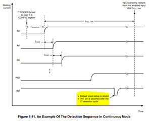

    I will note that the INT pin is always asserted LOW after the first detection cycle has completed following the TRIGGER bit getting set.  Could this be what you are seeing?

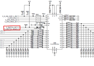

  • It is used by connecting two int pins (int pins of each TIC10024 device) to one pin C_SWITCH_INT of the MCU.
    As you said, I am trying to sense a switch input using two TIC10024s in parallel.

    When the voltage drops to enter the power saving mode of the two-use (parallel) controller, that is, lowpower, the INT pin of the device shows the action of High -> Low -> High.
    On the other hand, if only one MSDI is used, the value of the INT pin of the device is maintained as HIGH even if the voltage drops to enter low power.
    Due to the operation of High -> Low -> high at the INT pin of the device, the controller judges it as a wake signal, and the power saving mode of the controller is not executed.

    Additionally, the INT pin will always pull low immediately following the TRIGGER bit getting set to "1" to indicate the first cycle has completed and the default High/Low values for the INx pins has been measured.  The INx pins do not have to have changed states to cause the INT pin to pull low.  After this first cycle, any change on the INx level will cause the INT pin to pull low IF interrupt generation has been enabled for that INx channel.  By default, all Interrupt generation events are disabled.

    After using two MSDIs in parallel, there is a phenomenon where the int pin becomes Low even if all INx are not changed. (using 2 MSDI)
    If only one MSDI is used, the INT pin will remain HIGH under the same circumstances. (using 1 MSDI)
    From this it is Guessthat the Int pin is affected when using two MSDIs in parallel. Ask if there are any such effects.

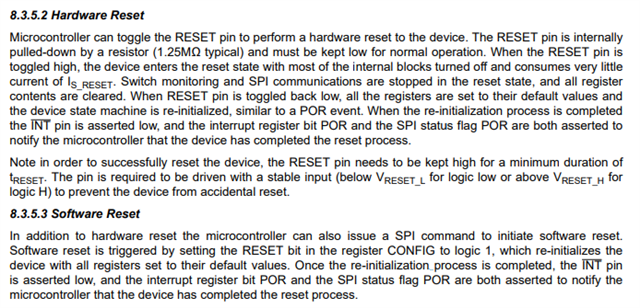

  • The nINT pin is an active-low, open-drain pin that asserts low when an event occurs.  When two devices have the nINT pins connected together in parallel, an event on either device can pull the line low.
    The Interrupt Enable Config 0 (INT_EN_CFG0) register can enable the possible events that will cause an interrupt and pull the nINT pin low outside of a couple of other events.  From your configuration, you only have the Switch State Change (SSC) enabled, and the nINT pin should not become active-low if an under/over voltage, temperature warning or shutdown, or parity fail event occurs.
    As I have already noted the nINT pin will also become active-low following the completion of the first polling cycle.  Your configuration shows the TRIGGER bit in the CONFIG register is set to 0, so neither device is actively polling.  When you enable the TRIGGER bits for the two devices, both devices will pull the nINT line low.  However, if you have not set either TRIGGER bit, then this is not the reason the nINT line is low.

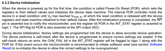

    As explained in the Device Initialization section of the datasheet, the nINT pin will also assert low after the initialization process is complete and following a Power On Reset (POR) event. A device Reset also causes the device to experience a POR event which will cause the nINT pin to be asserted.
    Your INT_STAT register does not have any bits set, including the POR bit, so I don't know if you have already read and cleared this register prior to reading it's value to report.  However, the since you don't have any interrupts enable except the switch state change, and you don't have the TRIGGER bits set which is required to monitor the switches for a state change, then the only likely cause for the nINT pin being asserted low is a POR event either from the device initialization or a hardware or software reset event.
    Can you tell which device is causing the nINT pin to be asserted low?  You state that when only one is used, the nINT pin stays high all the time.  Can you remove either one of the TIC10024 devices to keep the line high, or is it only one particular device that must be removed in order to keep the line high?
    When in the overall power up and device initialization sequence do you see the nINT pin become asserted low?  Monitoring the power supply ramping along with the nINT pins and SPI configuration registers should allow you to see what event occurred just prior to the nINT pin getting set.  This would then point to the possible cause.
    Is your MCU issuing a soft reset to the devices through SPI as part of the configuration sequence?  If so, this could also be something to verify.

  • Yes, the INT pin will be asserted LOW following a POR event as part of the Device Initialization sequence.  This is described in section 8.3.3 of the datasheet.  Both a Hardware and Software Reset will also cause a POR and the INT pin to be asserted LOW as described in sections 8.3.5.2 and 8.3.5.3 of the datasheet.

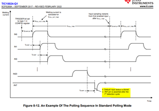

    Also, the INT pin is always asserted LOW after the first detection cycle completes after the TRIGGER bit is set as described in sections 8.4.1 and 8.4.2 of the datasheet.
    Other events can be enabled to generate an interrupt and assert the INT pin LOW, but the POR and First Polling Cycle complete following the TRIGGER bit getting set will always occur.
    If you are unable to break the parallel connection between the two TIC10024 units, I'm a bit confused about your original post that states your problem doesn't occur when only one device is used.
    We are currently using two TIC10024QDCPRQ1 MSDI.

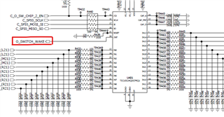

    In order to determine which device is causing the interrupt, you will either need to be able to read the device registers, or break the connection between the two devices or disable one of them.  I see in your schematic that you have test points on the Reset pins for both devices. You could supply voltage to one of the test points that would keep that device in a state of Reset while the other device is allowed to operate as normal.  You could then monitor your system and repeat the process for the other device to understand how each device is operating.
    However, in a general sense, the MCU firmware Interrupt Service Routine (ISR) should have the appropriate code to read and clear the TIC10024 registers when the INT pin is asserted LOW.  Because you have two devices sharing a single INT net, you will need to have the MCU read and clear the registers for both TIC10024 devices every time the INT pin is asserted LOW.
