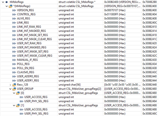

When I step into ICSS_EMAC_open() with the debugger, I can see no link on both of the stacked ICSSG Ethernet ports even if I connect/disconnect a cable on it.
In MDIO_phyLinkStatus(), I can see theses MDIO registers:
I wonder if is normal as in the API guide page, it is mentioned that some registers are not available (MDIO_VERSION_REG, MDIO_CONTROL_REG...) (See § "Impact")
If don't load the MDIO FW for Manual Mode setup, just to compare, I can see exactly the same reg values, weird...
It is as if the loading of MDIO FW in Manual Mode didn't work, that could explain the link not detected, according to i2329.
What could be the cause of the link status not detected on both Ethernet ports in my implementation?
Did I miss something?
Just to see, I also tried to load the demo project "enet_lwip_icssg_am243x-evm_r5fss0-0_freertos_ti-arm-clang", I can see the link state changing when I connect/disconnect the Ethernet cable, so the hardware is working fine.
