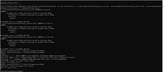

Dear TI experts,
We are setting up a AUTOSAR environment for AM2634 and so we are using startup asm files present in MCAL location "MCAL_AM263x_00.09.00_07\mcal\examples\Utils\CLANG"
I have a startup_file.o file being generated by using command
tiarmclang -x ti-asm -mcpu=cortex-r5 sys_core.asm sys_intvecs.asm sys_startup.asm -o "$(DEBUG_PATH)/Startup_file.o"
But fails in the LINKING stage where all the .o's are combined to generate .out file:
fatal error #10417: file "../Debug\Startup_file.o" could not be statically or dynamically linked
command used to link :
$(CC) $(CFLAGS) -DSOC_AM263X -D_DEBUG_=1 -gstrict-dwarf -g -Wall -Wno-gnu-variable-sized-type-not-at-end -Wno-unused-function -Wl,-m"$(OUT_PATH)/Core_0.map" -Wl,-i"$(Kernel_Lib)" -Wl,-i"$(Driver_Lib)" -Wl,-i"$(Board_Lib)" -Wl,-i"$(Compiler_Lib)" -Wl,--reread_libs -Wl,--diag_suppress=10063 -Wl,--diag_wrap=off -Wl,--display_error_number -Wl,--warn_sections -Wl,--xml_link_info="$(OUT_PATH)/Core_0.xml" -Wl,--ram_model -o "$(OUT_PATH)/Core_0.out" $(ORDERED_OBJS)
Am I following correct way for asm startup files linkage ? Can you please guide us on how should we link startup asm files ?
    Can you please provide the below info?
    1. If you're compiling the above files with the argument "-s" in the command, can you please remove it to make the logs more verbose?, this prints the exact command used while linking and I can look into what is wrong with the step.
    2. Can you ensure you have provided the linker command file? It is this file lnk_r5_am263_CLANG.cmd which comes along with the MCAL delivery itself.
  • Hi
    1) I have used the LINKER that comes with MCAL package "lnk_r5_am263_CLANG.cmd".
    2) You can see the linking stage logs below without -s or @ :
     Building Startup files ...
    C:/ti/ccs1120/ccs/tools/compiler/ti-cgt-armllvm_1.3.1.LTS/bin/tiarmclang -x ti-asm -mcpu=cortex-r5 ../source/application/startup/sys_core.asm ../source/application/startup/sys_intvecs.asm ../source/application/startup/sys_startup.asm -o "../Debug//Startup_file.o"
    "../source/application/startup/sys_core.asm", WARNING! at line 61:
     [W0003]
             Assembly-source debug directives cannot be used when debug
               information is disabled; ignoring all assembly-source debug
               directives
                .asmfunc
    No Assembly Errors, 1 Assembly Warning
    "../source/application/startup/sys_intvecs.asm", WARNING! at line 53:
     [W0003]
               directives
                .asmfunc
    "../source/application/startup/sys_startup.asm", WARNING! at line 105:
     [W0003]
               directives
                .asmfunc
    make[1]: Leaving directory 'C:/Project_Orange/Core_0/Make'
    make[1]: Entering directory 'C:/Project_Orange/Core_0/Make'
    Linking ....
    C:/ti/ccs1120/ccs/tools/compiler/ti-cgt-armllvm_1.3.1.LTS/bin/tiarmclang -mcpu=cortex-r5 -mfloat-abi=hard -mfpu=vfpv3-d16 -mlittle-endian  -DSOC_AM263X -D_DEBUG_=1 -gstrict-dwarf -g -Wall -Wno-gnu-variable-sized-type-not-at-end -Wno-unused-function -Wl,-m"../../Build_Output/Core_0.map" -Wl,-i"C:/ti/mcu_plus_sdk_am263x_08_03_01_05/source/kernel/nortos/lib" -Wl,-i"C:/ti/mcu_plus_sdk_am263x_08_03_01_05/source/drivers/lib" -Wl,-i"C:/ti/mcu_plus_sdk_am263x_08_03_01_05/source/board/lib" -Wl,-i"C:/ti/ccs1120/ccs/tools/compiler/ti-cgt-armllvm_1.3.1.LTS/lib" -Wl,--reread_libs -Wl,--diag_suppress=10063 -Wl,--diag_wrap=off -Wl,--display_error_number -Wl,--warn_sections -Wl,--xml_link_info="../../Build_Output/Core_0.xml" -Wl,--ram_model -o "../../Build_Output/Core_0.out" "../Debug//*.o" "./lnk_r5_am263_CLANG.cmd" -Wl,-lnortos.am263x.r5f.ti-arm-clang.debug.lib  -Wl,-ldrivers.am263x.r5f.ti-arm-clang.debug.lib  -Wl,-lboard.am263x.r5f.ti-arm-clang.debug.lib  -Wl,-llibc.a
    tiarmclang: error: tiarmlnk command failed with exit code 1 (use -v to see invocation)
    Makefile:89: recipe for target 'link' failed
    make[1]: *** [link] Error 1
    Makefile:55: recipe for target 'all' failed
    make: *** [all] Error 2
     [W0003]
               directives
                .asmfunc
     [W0003]
               directives
                .asmfunc
     [W0003]
               directives
                .asmfunc
    Linking ....
    C:\Project_Orange\Core_0\Make>

  • Hi Prashanth,
    Thanks for this, There's only one reason i could think of. The build system is not able to locate the objects "Startup_file.o", please ensure these are present in the directory Debug/ after building them. That's mostly the root cause.
  • Hi , I verified that the file is existing on debug folder:
    As highlighted below: it parses all the .o files from Debug directory while linking and also fed with Linker command file while linking.
    Linking ....
    C:/ti/ccs1120/ccs/tools/compiler/ti-cgt-armllvm_1.3.1.LTS/bin/tiarmclang -mcpu=cortex-r5 -mfloat-abi=hard -mfpu=vfpv3-d16 -mlittle-endian -DSOC_AM263X -D_DEBUG_=1 -gstrict-dwarf -g -Wall -Wno-gnu-variable-sized-type-not-at-end -Wno-unused-function -Wl,-m"../../Build_Output/Core_0.map" -Wl,-i"" -Wl,-i"" -Wl,-i"" -Wl,-i"" -Wl,--reread_libs -Wl,--diag_suppress=10063 -Wl,--diag_wrap=off -Wl,--display_error_number -Wl,--warn_sections -Wl,--xml_link_info="../../Build_Output/Core_0.xml" -Wl,--ram_model -o "../../Build_Output/Core_0.out" "../Debug/*.o" "./lnk_r5_am263_CLANG.cmd"
    One more observation: if I remove the startup_file.o and use a normal linker, I am able to generate .out file for flashing but with startup_file.o and with lnk_r5_am263_CLANG.cmd I am gettting a error as could not be statically or dynamically linked.
  • Hi Prashanth,
    Looks like the command used here is also little different from what MCAL used, Please refer to the below command I observed when compiling the MCAL package.
    /home/kowshik/ti/ti-cgt-armllvm_2.1.2.LTS/bin/tiarmclang -Wl,--emit_warnings_as_errors -Wl,--warn_sections,-qq,--undef_sym=_c_int00,--rom_model,--diag_suppress=10068 -Wl,-mcpu=cortex-r5,--diag_suppress=10063 -Wl,-qq,--diag_warning=225,--diag_suppress=23000 -Wl,-a,--rom_model,--warn_sections,
    --reread_libs,--unused_section_elimination=on,--compress_dwarf=on,--copy_compression=rle,
    --cinit_compression=rle  /home/kowshik/Documents/mcal_releases/MCAL_AM263x_00.09.00_07/mcal/binary/ipc_notify_app/obj/am263/r5f/release/sys_intvecs.oer5f
    /home/kowshik/Documents/mcal_releases/MCAL_AM263x_00.09.00_07/mcal/binary/ipc_notify_app/obj/am263/r5f/release/sys_startup.oer5f
    /home/kowshik/Documents/mcal_releases/MCAL_AM263x_00.09.00_07/mcal/binary/ipc_notify_app/obj/am263/r5f/release/Cdd_Ipc_notify_app.oer5f
    /home/kowshik/Documents/mcal_releases/MCAL_AM263x_00.09.00_07/mcal/binary/ipc_notify_app/obj/am263/r5f/release/Cdd_Ipc_PBCfg.oer5f
    /home/kowshik/Documents/mcal_releases/MCAL_AM263x_00.09.00_07/mcal/binary/ipc_notify_app/obj/am263/r5f/release/Port_PBcfg.oer5f
    /home/kowshik/Documents/mcal_releases/MCAL_AM263x_00.09.00_07/mcal/binary/ipc_notify_app/obj/am263/r5f/release/Mcu_PBcfg.oer5f
    /home/kowshik/Documents/mcal_releases/MCAL_AM263x_00.09.00_07/mcal/binary/ipc_notify_app/obj/am263/r5f/release/Mcu_Cfg.oer5f
    /home/kowshik/Documents/mcal_releases/MCAL_AM263x_00.09.00_07/mcal/binary/ipc_notify_app/obj/am263/r5f/release/Os.oer5f
    /home/kowshik/Documents/mcal_releases/MCAL_AM263x_00.09.00_07/mcal/binary/ipc_notify_app/obj/am263/r5f/release/Dem.oer5f
    /home/kowshik/Documents/mcal_releases/MCAL_AM263x_00.09.00_07/mcal/binary/ipc_notify_app/obj/am263/r5f/release/Det.oer5f -Wl,--output_file=/home/kowshik/Documents/mcal_releases/MCAL_AM263x_00.09.00_07/mcal/binary/ipc_notify_app/bin/am263/ipc_notify_app_r5f_release.xer5f,--map_file=/home/kowshik/Documents/mcal_releases/MCAL_AM263x_00.09.00_07/mcal/binary/ipc_notify_app/bin/am263/ipc_notify_app_r5f_release.xer5f.map,../../lnk_r5_am263_CLANG.cmd
    -l/home/kowshik/Documents/mcal_releases/MCAL_AM263x_00.09.00_07/mcal/binary/Ipc/lib/am263/r5f/release/ipc.aer5f
    -l/home/kowshik/Documents/mcal_releases/MCAL_AM263x_00.09.00_07/mcal/binary/Mcu/lib/am263/r5f/release/mcu.aer5f
    -l/home/kowshik/Documents/mcal_releases/MCAL_AM263x_00.09.00_07/mcal/binary/Port/lib/am263/r5f/release/port.aer5f
    -l/home/kowshik/Documents/mcal_releases/MCAL_AM263x_00.09.00_07/mcal/binary/examples/Utils/lib/am263/r5f/release/app_utils.aer5f
    # /home/kowshik/Documents/mcal_releases/MCAL_AM263x_00.09.00_07/mcal/binary/ipc_notify_app/bin/am263/ipc_notify_app_r5f_release.xer5f created.
    I see slight difference where the application object files are being linked to the executable with the parameters of out file, map file and linker file.
    G Kowshik
  • Hi , I went through the build makefile logs and used all the flags that was used for compilation. Now I am able to link the files. **Root Cause is flags were missing which was present in mcal makefile build environment.
    Issue is solved.
    Thanks & Regards,
    Prashanth Arun
