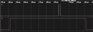

  • I did similar test, and didn't see the issue. Enabling ESM LOW interrupt doesn't impact on the execution of RTI and ADC:
  • This is my the main() I used for the test:
    1. RTI: compare 0 interrupt is enabled, the compare 0 period is 100us (GIOB.1 toggle)
    2. ESM Low Interrupt is enable or disabled (VIM channel 20), and ESM Group1 channel 19
    3. ADC sampling is triggered by GIOB.0 rising edge
