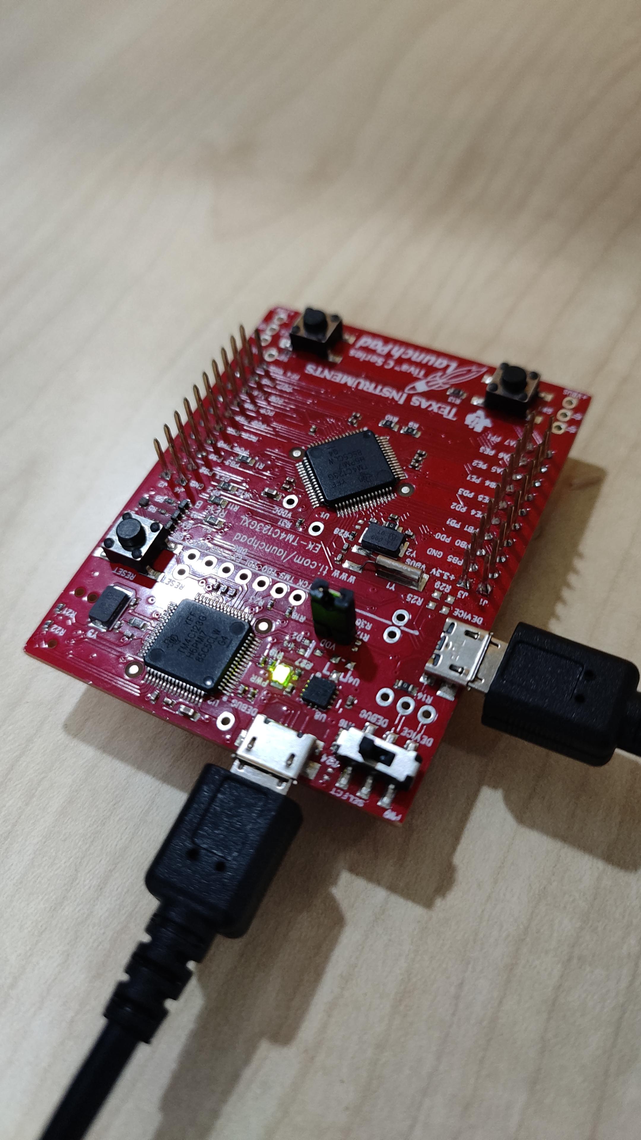

  • Above i attached image. is there any mistake i done or not ? because still after starting debug mode application of mine is not working.
  • First of all, you are showing two identical pictures.
    - Are you having two boards or just one board?
    - If you only have one board, I suppose you connect both ports on the board to your host machine, right? Your picture does not show where they are connected to. With that said, it is correct that that you need one cable connected to the USB debug port and another cable connected to the USB device port in order to run usb_dev_serial example.
    - I will suggest you first run the example on the Windows PC. Make sure it works as expected. The usb_dev_serial example is supposed to work right out of the box. Run on a Windows machine will help you isolate the problem if the current problem is Linux related. I'm not well versed in Linux commands but I think you can use ls /dev/tty* to show the connected port.

  • Sorry to repeat again. i am using linux with CCS. I am running my application not your given example code. Because i have to find where i made the mistake.
    i don't know but when i debug at that time i am not getting data into USBRingBufRead.
      I really suggest you start with a usb example to get a feel of the usb library. If you can get it to work, you can reference it to build your own application.
