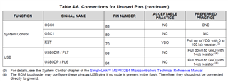

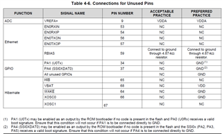

I am connecting up this part in my design.  We are not using Ethernet.  How shall I connect those pins on the part?
On the development board I see Vddc and its return Vss, but I cannot see where this supply comes from and how it is to be connected.
I am not using the A/D converter.  How shall Vdda be connected?
Lastly, I am not using hibernate nor the battery, how should those pins be connected for proper operation?
      Please follow the Connections for Unused Pins in the datasheet.
    You can connect VDDA to ground if you are not using ADC.
    See above table.

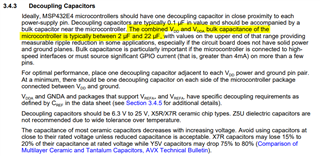

  • Thank you gents.  I missed the table.  I am connecting up Vdda to Vcc, but do I need to bother with decoupling?  My design is very tight on space.   This is an inherited design and I would love to steal the capacitors that were dedicated for that function for the digital rail.

  • but do I need to bother with decoupling?  My design is very tight on space.   This is an inherited design and I would love to steal the capacitors that were dedicated for that function for the digital rail.
    You do not need a separate decoupling cap for VDDA if you are going to combine VDDA and VDD together. You need decoupling cap for stable power supply to the device. Please follow https://www.ti.com/lit/pdf/slaa770 as suggest for decoupling cap. 2uF to 22uF is the bulk cap for combined VDD and VDDA.
