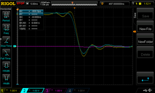

  • no not quite what I was looking for, I have a datasheet for a chip that I am trying to communicate with that says MOSI must be held for 9 nanoseconds after clock, their support says this requirement must be met, and I am checking if there is a software way of doing it. In the timing diagram Th(SO) time is what I am trying to meet.
    With The TMS570 we checked the timing of this in different modes and there is a slight variation and is there some type of way to control it>
    The plots below show that the TMS570 (clock in yellow and MOSI in blue) changing at almost the same time, and we need it to change like the second scope plot where the clock changes first before the MOSI changes.
    So this is not a mode shift or a phase delay, is there some other type of control for it?
    The way we are going to test is is by changing the SPI lines to GPIO and code everything, but we would prefer to use the automated SPI process.

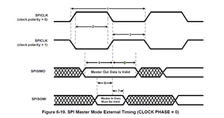

  • Hi Dan,
    The parameter you are mentioning is the 5th parameter in datasheet.
    It is nothing but a time for which data is valid after sampling edge of the CLK.
    tv(SPCL-SIMO)M = 0.5tc(SPC)M – tf(SPC) – 4
    tv(SPCH-SIMO)M = 0.5tc(SPC)M – tr(SPC) – 4
    In this formula
    tv = valid time
    tc = cycle time
    tf = falling time
    tr = raising time
    So valid time will be depending on cycle time and either raising or falling time.
    If your SPI operate with highest frequency of 25Mhz then cycle time will be 40ns
    so, after we are substituting it in above formula the minimum valid time of SPI will be as below
    tv(SPCL-SIMO)M = 16 – tf(SPC)
    tv(SPCH-SIMO)M = 16 - tr(SPC)
    So, at this frequency to meet your requirement 9 nanoseconds the rise time or fall time should not be more than 7nanoseconds.
    There is no software configuration to increase tv, we have to make sure rise time should be less than 7 nanoseconds or else we have to reduce the frequency so that tv time will get increased.
