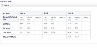

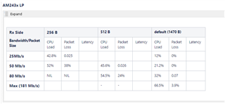

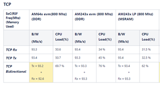

Hi Hideaki,
Please find below numbers from SDK 8.4 release. These are not optimised numbers. We will have a new data from 8.6 SDK release planned in Mid may
