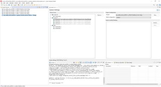

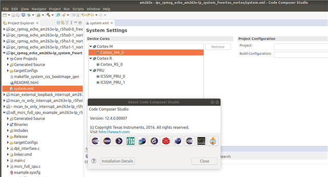

Hi expert.
    Customer reports that they have question to use syscfg tool for multicores project. They import ipc_notify_echo_am263x-lp_system_freertos_nortos from SDK8.5 and would like to modify it to enable lockstep for R5FSS1-0 & R5FSS1-1. However, system.xml only shows one R5F0-0 in syscfg editor and project property shows the chip they are using is AM2631. They can't not change it.
Is this normal?? or something wrong with syscfg?

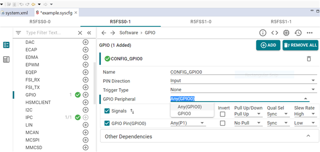

Beside, if they want to add GPIO in R5F0-1, in TRM we say we have GPIO0,1,2,3. Each core has corresponding GPIO module.  But in syscfg,  we only have GPIO0 can use for all cores.
Can you please check? How to fix it? or something wrong in TRM?
Andre
  • Hi Andre,
    The CCS system xml file is used as a group project which includes all the CCS projects for each R5F cores or M4F core. It does not have its own sysconfig file. Each CCS project has its own sysconfig file where all the resource used by this CCS project file are defined.
    The advantage to use the system project file is that you can build, load, debug all CCS projects at the same time. Also the system configure tool will check the potential pinmux conflicts among the CCS projects in the same system project.
    As of the GPIO, there are 4 GPIO instances for AM263x, each for one R5F core. Apparently, there is a bug in the sysconfig tool, because all four example.syscfg files in the IPC example are pointing to the GPIO0. I have filed a JIRA ticket for this issue: [MCUSDK-10166] AM263x: System Configure Tool only allow to use GPIO0 for all R5F cores - Texas Instruments JIRA (ti.com)
    Ming

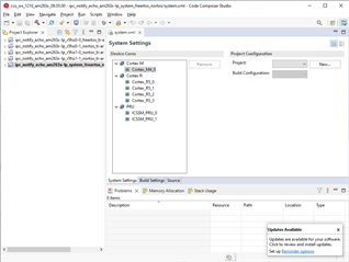

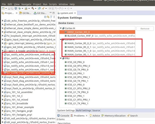

       Question here are:
    1. How to assign project to each core if you only have one R5F there?
    Would you please show us no matter import from IPC or create from empty example, if you only have AM2631 option, how create multiple cores project ?
    Just for you reference, AM243x can show all cores in IPC demo project.
    2. for GPIO Question, since this is a syscfg tool issue, what is temporary workaround?
    Andre

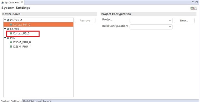

  • Hi Andre,
    Unfortunately, for some reasons, all the CCS projects including the system project are made based on the AM2631. That is why there only one R5F core. Also the core ID used in the system.xml is incorrect. It should be "Cortex_R5_0" instead of "MAIN_PULSAR_Cortex_R5_0_0" (It looks like a cut-n-paste error from AM243x). I filed JIRA ticket for this issue: MCUSDK-10167
    For the GPIO issue, since it is a syscinfig tool issue, there is no workaround right now.
    Ming

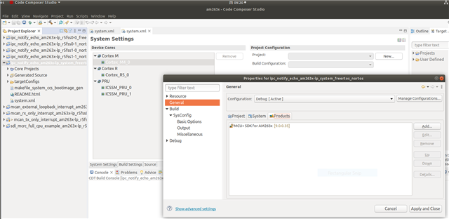

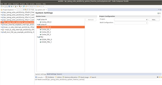

  • Ming,
        Please refer to capture from SDK9.0.0.35. This issue is not solved.
    Please check when can we solve this problem. Thanks
    Andre

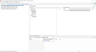

  • Hi Andre,
    The issue is with the CCS version. I just tested the AM263x MCU+ SDK 08.06.00 and 08.05.00 with the CCS 12.1.0. They both worked OK:
    But the AM263x MCU+ SDK with CCS 12.4.0 still not working. I will update the JIRA ticket (MCUSDK-10167) accordingly.
    Ming
  • Hi Andre,
    We figured it out. The issue was caused by the CSP for AM263x. You will need to update the CSP by following the instructions from the following link:
    Update the Sitara CSP to 1.2.4.AM263x MCU+ SDK: Download, Install and Setup CCS (ti.com)
    Ming

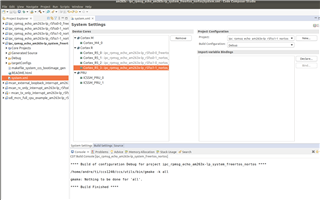

  • Ming,
        Multicore option can be shown after modify timestamp file. However, the project assigned to each core is empty.
    After we assigned project to each core manually, then build from system project. CCS will DO NOTHING. No binary or image will be generated.
    Issue is not solved correctly.

  • Hi Andre,
    The issue has been fixed in MCU+ SDK for AM263x 09.00.00.0033. I imported the ipc_notify_echo_am263x-cc_system_freertos_nortos in CCS 12.4.0 with the CSP updated first). Here is the CCS window looks like:
    When I build the ipc_notify_echo_am263x-cc_system_freertos_nortos, all 4 sub projects build automatically.
