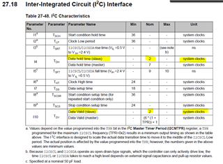

I am using TivaWare_C_Series-2.2.0.295 SDK to debug I2C 3.4Mhz high speed performance.  TI_I2C_3.4Mhz Master sending and reading are fine, but when it is working as Slave mode, find there is no high speed performance, which means when 3rd party Master sends slave address followed by master code, TI_I2C_slave feedback NACK, looks it cannot respond ACK under high speed mode. Confirm it standard speed mode, TI board as Slave no problem.
Is any good suggestion?

  • Hi Hongwei,
      Not really sure what is the cause of the problem. Are you meeting the I2C electrical characteristic requirements for I4 and I10 parameters  shown in the datasheet. See below table. What is the your system clock speed? What pullup resistor do you use? For high speed operation, I would have expected a stronger pullup (lower resistance value) compared to the stand speed for 100kHz. Does it make a difference if you change the pullup resistors?

  • Hi Hongwei,
      I feel it has something to do with the timing (e.g. setup or hold time).  As you indicated, it will work at around 3Mhz but not 3.4Mhz.  Did the slave capture wrong data in its FIFO or simply not capturing anything?
      Can you do one experiment? Instead of running system clock at 120Mhz, can you try a lower speed. Maybe start with 25Mhz using OSC as the source clock instead of using PLL. I just wanted to know if there is any relationship between the system clock speed and your observation.
