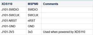

I'm working on getting a launchpad and debugger from my FAE, but i'm trying to finish up some schematics for our own design as well.
What debugger and connection/header should i use to program/debug the micro controller?
it seems that SWD is the expected method?
Does TI recommend a particular debugger?
It seems that SWD debuggers are fairly common, is it ok to non-ti with CCS?

  • what connection/header is required for xds110?
  • the info you gave me tells me that i have to connect 5 signals, but it doesn't include the connector or the connection information.
    maybe i haven't been clear in the previous 2 posts...
    1) what connector?
    2) what is the connector pinout?
    I assumed there would be a 6 pin header that i could use, but i'm not seeing that as an option with the xds110, i dont see it as a cable or adapter.
    if this is an option then ignore the reset of this post.
    as best as i can see there is a 10 pin adapter to use with a 20 pin cable.
    there are a lot of data sheets to comb through, so i apologize if you think that its super obvious and i missed it.
    i found this page, but its not specifically for the M0.
    i found this: software-dl.ti.com/.../emu_jtag_connectors.html
    as best as i can tell, i follow the arm-10pin.  but this document uses words that it doesn't even define...
    pin arm-10pin mspm0 schematic
    1 VTRef 3.3V
    2 SWDIO / TMS SWDIO
    3 GND GND
    4 SWDCLK / TCK SWCLK
    5 GND GND
    6 SWO / TDO NC?
    7 KEY KEY
    8 NC / TDI NC
    9 GNDDetect GND?
    10 nRESET nRESET

    The connecter is J101 and the detail signal defines you can see it on the silk screen or the schematic as below
    MCU098_LP-MSPM0G3507_Schematic.pdf
  • J101 is an 18 pin connector to hold 5 signals that i need.  are you sure?
    J103 is 10 pins and only has what i think is the needed pins.

    so connecting some dots which are not spelled out explicitly, between teh schematic you linked to, the xds110 user guide and the link i proved above...
    i should use the connector and pinout of J103 and it will work with the Cortex-M 10 pin adapter.
  • Ok, I think you are using the stand along XDS110 https://www.ti.com/tool/TMDSEMU110-U?keyMatch=XDS110
    Right?
    If so, you can use 10pin connector  as the below signals. but it not include power supply so you need to provide a power supply to your board.
