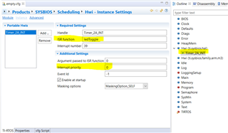

  • Hi Mike,
      Not sure if you had a chance to try out the zero-latency interrupt. Below is what I tried on a TM4C123 device.
    In the .cfg file for this example, I change the interrupt priority to 0.
    For the ISR ledToggle, I add the keyword interrupt
    // ledToggle()
    // toggles LED on Tiva-C LaunchPad
    void interrupt ledToggle(void)
    TimerIntClear(TIMER2_BASE, TIMER_TIMA_TIMEOUT); // must clear timer flag FROM timer
    // LED values - 2=RED, 4=BLUE, 8=GREEN
    if(GPIOPinRead(GPIO_PORTF_BASE, GPIO_PIN_2))
    GPIOPinWrite(GPIO_PORTF_BASE, GPIO_PIN_1|GPIO_PIN_2|GPIO_PIN_3, 0);
    else
    GPIOPinWrite(GPIO_PORTF_BASE, GPIO_PIN_2, 4);
    i16ToggleCount += 1; // keep track of #toggles
    Log_info1("LED TOGGLED [%u] TIMES",i16ToggleCount); // send toggle count to UIA
