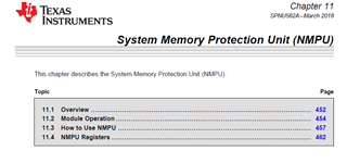

Can you illustrate how to use use NMPU module to detect stack underflow fault? Thanks a lot.
Do you mean MPU or NMPU?
MPU is for CPU, but NMPU is for other master such as DMA. The stack is used by CPU only.

Hi QJ,
I just find NMPU in TRM. Where is MPU and how to get the introduction about "MPU subregion or overlay region for stack protection"?

Hi QJ,
I don't find MPU related operation in HALCOGen program, but just NMPU.

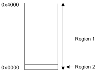

You can use sub-region or overlap region for stack overflow or stack underflow protection:
1. overflow
• allocate to region 1 the appropriate size for all stacks
• allocate to region 2 the minimum region size, 32 bytes, and position it at the end of the stack for the current process
• set the region 2 access permissions to No Access.
Stack region: 0x20 ~ 0x4000
2. underflow
• allocate to region 2 the minimum region size, 32 bytes, and position just above the stack region (0x3FE0~0x4000) for the current process

In my understanding, it must cause permission fault if we just set the region 2 access permissions to No Access.
You are correct. The permission fault will be generated when stack is overflowed or underflowed.
What's the purpose of the first two steps before the step "set the region 2 access permissions to No Access" for this test?
When stack is full, the push operation will push data to region #2 and generate permission fault.
When stack is empty, the pop operation from region #2 will generate permission fault too.
