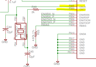

I want to measure the frequency of the 32kHz crystal connected to the XOSC0 and XOSC1 pins of the microcontroller (as in the screenshot below).

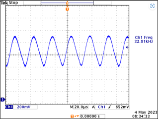

I'm connecting one end of the scope's probe to the GND and the other end to either of the two ends of the crystal but I'm not able to see the 32kHz oscillations whereas I can easily capture the other crystals, i.e.,25MHz frequency.
Also, what is this crystal used for?
