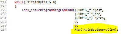

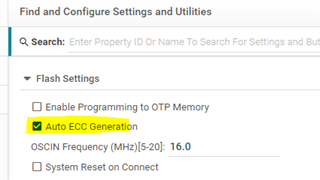

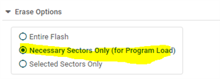

I'm working on implementing a bootloader to update an RM46 over CAN. I've based my project the example CAN bootloader provided by TI and have been reasonably successful. I'm at the stage now where having successfully written the received image to flash, I'm attempting to boot into the image. However, when I do this, I get caught in a prefetch system interrupt (address 0x1002C).
Some background information:
  • ECC (ram) is enabled for the bootloader, however I currently have it disabled (ram & flash) for the main application.
  • The Main application is an existing application that works when programed with CCS
    • I do not have Auto ECC Generation enabled in CCS
    • I erase the necessary sectors only (for Program Load)
  • I cannot boot the main application when I load the bootloader and the main application through Uniflash (boot to app is forced)
  • I have adjusted the linker file for the main application to direct to what I believe are the correct locations.
  • I have sys_intvecs.asm of the bootloader redirecting to the location of the vector for the main application in flash.
Below you'll find copies of both linker files, and attached, the HALCoGen project files.

    If you want to generate ECC using Linker CMD script, the "Auto ECC Generation" should be disabled when loading the *.out file.
    1. load bootloader with "Auto ECC Generation" enabled, and "Necessary Sectors only"
    2. then load Application with the same settings.
    3. The application starts from 0x10020 (VECTORS), so the destination address of the branch instruction in bootloader should be 0x10020:
    g_ulTransferAddress = (uint32_t)0x10020;
    ((void (*)(void))g_ulTransferAddress)();
    or
    ((void (*)(void))0x10020)();
  • Okay, thank you, that is consistent with how I have it set up. When I attempt to enable ECC in the bootloader, I encounter an abort when attempting to jump to  the _errata_CORTEXR4_66_() function.
    I did do some reconfiguration and set the start of vectors to 0x10000, but I can't imagine that's a problem. I did away with storage of the boot flag and all that in my implementation.
  • Sorry, I just want to clarify,
    This should be disabled correct?
  • Yes, Because you use the Linker CMD to generate ECC, the "Auto ECC Generation" should be disabled.
