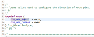

 We are faced an issue while testing Dio write.
In Dio_pvt.h.
Definition for
DIO_DR_INPUT = 1 and DIO_DIR_OUTPUT = 0.

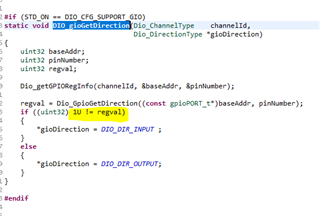

But in Dio.c,
DIO_gioGetDirection is called to get the direction of configured pin. Bu in that code. DIO_DIR_INPUT value is checked against zero to make it into input as direction. please find below the code portion.
 Could you please confirm.
