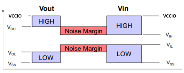

  • he problem is that certain devices, which are controlled by the "HOST" microcontroller, require a voltage very close to 3.3V, so the voltage dip must be as small as possible
    As far as I knew that most of 3.3V CMOS MCU has VIH of 2V, and VOH is higher than VIH. VOH-VIH is the noise margin.
    For TMS570, VIH(min)=2V, VIL(max)=0.8V, VOH(min)=3V, and VOL(max)=0.2V
            The HIGH state noise margin is: VOH(min)-VIH(min) = 3V - 2V = 1V
            The LOW state noise margin  is: VIL(max) - VOL(max) = 0.8V - 0.2V = 0.6V
    What are the spec value of VIH and VIL of the HOST MCU?
  • Hi QJ Wang,
    The RM46L852 works as you have told me, but the micro-SDXC is more restrictive, from what I have read of the Physical layer specification of the SD Card, it recommends a value approx to 3.3V. However, it have checked this documents and I have verified that:
