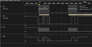

Here is a scope capture of the digital signal with the analog equivalent:
In the initialization, I pass I2CMasterInitExpClk(...) I pass I2C_MASTER_SLOW_MODE which is false. Per the API documentation, I would expect this to provide clock speeds of 100kbps; however, it looks like it is using the fast mode of 400kbps in this example. Any thoughts? When I pass true as that param, the device uses super fast mode of 1Mbps. I even try setting the MCLKOCNT register directly through the I2CMasterTimeoutSet function, but it doesn't seem to have an effect.
Judging by the looks of the analog lines, this definitely seems too fast for the slave (which is only rated for 100kbps). I believe part of my data acquisition issues are related to this clocking speed. Though I am not confident in how I am reading the 2 bytes back from the slave.  Below is an image of the capture when I try to read the serial number from the slave.
The first byte I get back, the 0x39, is correct; however, that 0xFF is not. Any recommendations on how to better utilize the API to poll 2 bytes?
Thank you

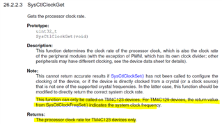

  • Hi Zach,
      I think first thing first. There is a mistake in the below line. You cannot call SysCtlClockGet() for TM4C129 MCU. SysCtlClockGet is only for TM4C123 MCU. This mistake very likely messes the I2C clock.
    I2CMasterInitExpClk(I2C1_BASE, SysCtlClockGet(), I2C_MASTER_SLOW_MODE); // slow mode = 100kbps transfers
     Please change to something like below instead.
    g_ui32SysClock = MAP_SysCtlClockFreqSet((SYSCTL_XTAL_25MHZ |   // Configure the system clock according to your application requirement. This is an example.
    SYSCTL_OSC_MAIN |
    SYSCTL_USE_PLL |
    SYSCTL_CFG_VCO_240), 120000000);
    snip...
    I2CMasterInitExpClk(I2C1_BASE, g_ui32SysClock , I2C_MASTER_SLOW_MODE); // slow mode = 100kbps transfers
