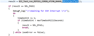

3). Another strange thing is that the 2BitInjectTest or 1BitInjectTest sometimes can't pass, and the test stalls in the following loop:

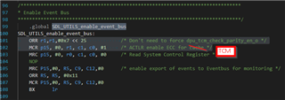

    Thanks. And I also found that in 'SDL_UTILS_enable_event_bus' function, it will enable the ECC for TCM as well:
    So that means ECC init for TCM can be removed...
    Will
  • Hi Will,
    As mentioned in the meeting and message, the ECC (TCM and SRAM) is not enabled by default. It have to be enabled before the memory init which generates ECC code for the memory content. If the ECC is not enabled, you will get corrupted data when reading the memory. I noticed that the memory in memory init function may not be correct in lockstep mode (ATCM is 0x4000, and BTCM is 0x2000).
    Yes, you can remove the ECC enable function call in ECC init function.
    When running your project, the code gets stuck at:
