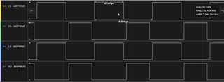

We have a custom board using the TM4C1292NCPDT.
The board will be using two interleaved PWM signal pairs. Currently, I am running PWM Gen 0 and PWM Gen 1 in UP-DOWN mode. Is there a way to offset the generator blocks so they are 180 degrees out of phase using the TI SW API? For example, in the image below, I want L1 and L2 to be 180 degrees out of phase and H1 and H2 to be 180 degrees out of phase, while retaining the same duty cycles. Is there a way in the SW API to set the starting count of one of the generators to accomplish this? The duty cycle will change during runtime, so it needs to be a true, 180 degree phase shift (instead of inverting a 50% duty cycle signal).
Here is the corresponding init code:

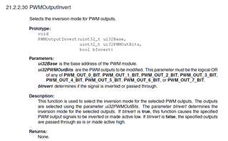

      You can invert L2 and H2 to make them 180 out of phase with L1 and H1.

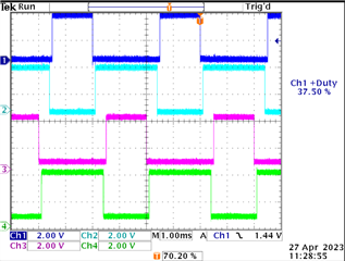

  • Wouldn't this swap the duty cycles too? So if the duty cycle for L1 is 40%, then the inverted duty cycle for L2 would be 60%. I want both to have a 40% duty, but L2 just needs to occur exactly half a period later.
  • As I play with the inversion function, it looks like it is offsetting the signals correctly; however, it's not accounting for the dead band correctly. It's almost as if I need to write in a negative deadband. The deadband that gets put in is actually added onto the rising and falling edges, instead of subtracted. So the best I can get is zero deadband, which is an issue. I need some guarantee those L2 and H2 will not ever be high at the same time. Is there a way to apply a negative deadband to the inverted signal?
      I think you should be able to synchronize GEN0 with GEN1 and create the phase relationship between L1 and L2.
    Synchronized. The PWM generator and its two outputs signals are used in conjunction with

      Do you still need help on setting up 180 degree out of phase PWM? TivaWare API does not natively support this. You will have to get around the API to achieve this. I was able to get two pairs of dead-band signals and the two pairs are 180 out of phase with each other. See below.
    I modify the stock example pwm_dead_band.c.
