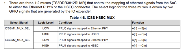

I want to map the PRU1 signal to the Ethernet PHY.
Here's a screenshot from the user guide:
Is there any example code to make the IO expander send a LOW signal to these muxes?

You can take reference from ethercat beckoff ssc demo present in SDK:
examples\industrial_comms\ethercat_slave_beckhoff_ssc_demo\am263x-cc\tiescsoc.c
This file contain tiesc_socEvmInit function which contains the details.
Please Let me know if this helps.
