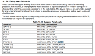

    This is a expected behaviour, because when you free-run the core, the timer increments normally, however your expectation might be that during the debug the timer peripheral halts when the core pauses, this is not true because the Halt EN bit is not SET. Which means the timer still continues to operate in the Free running mode even when the core is paused. To make the observations you expect, please write 0x1 to enable the following register 0x50D00454, TRM also have this information

  • Hi, thank you for the answer.
    Yes setting that register as you say it solves the issue I was facing.
    For reference here is some code that would set the HALTEN of RTI0 i.e. if the Core R5A0 is used:
    #include <drivers/hw_include/soc_config.h>
    HW_WR_FIELD32(CSL_MSS_CTRL_U_BASE + CSL_MSS_CTRL_RTI0_HALTEN, CSL_MSS_CTRL_RTI0_HALTEN_CR5A0_HALTEN, 1);
