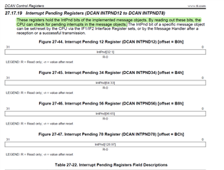

How to get the message box ID inside the canStatusChangeNotification ISR?
I tried the following without success.
void canStatusChangeNotification(canBASE_t *node, uint32 notification)
    if ((notification & canLEVEL_RxOK) != 0)
        // Wait until IF2 is ready for use
        while ((node->IF2STAT & 0x80U) == 0x80U)
        uint8_t const msgbox = node->IF2NO;
For context, here's what I'm trying to do:
I want to know how many CAN frames my message boxes receive per second to make sure other devices on the bus have not timeout.
Note that I don't necessarily want to use the data inside the message box; just know how much time has elapsed since a message was received.
