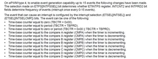

I believe that Syscfg is missing the ability to select the event "Time-base counter equal to zero or period (TBCTR =0x00 || TBCTR = TBPRD)
Also are mix events not available in AM263x?

Have you upgraded your SDK to the latest version 8.6?
This was an issue in 8.5 and its fixed in the latest SDK Syscfg.
First you choose the mixed events option,
Then you will choose which combinations of events do you want for the interrupt.
Feel free to let me know if you face any further issues.
