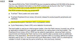

    Also, are there decryption algorithms customers can copy/use from driverlib or something or do we have to write our own decryption algorithms from scratch (leveraging the AES internal peripheral I'm assuming).
    The TM4C123 ROM bootloader does not do the decryption for you automatically but flash bootloader can optionally be configured to do so. With that said, TM4C123 does have the AES algorithm stored in the ROM that users can use. Please refer to TM4C123 ROM user's guide for details at https://www.ti.com/lit/pdf/spmu367
