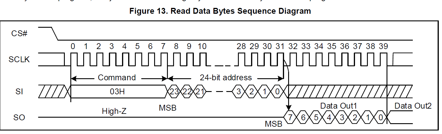

My customer is willing to use GD25F128FWAGR QSPI flash memory in their AM2634 custom board and requested to check if it can be used with AM2634.
When I checked the MCU+ SDK UG, I found only below limitation for QSPI boot.
https://software-dl.ti.com/mcu-plus-sdk/esd/AM263X/08_06_00_34/exports/docs/api_guide_am263x/CUSTOM_FLASH_SUPPORT_GUIDE.html
The QSPI interface present in the SOC can support only the 1S-1S-1S mode or the 1S-1S-4S modes for reading from the flash.
Is there anything else to check flash memory compatibility with AM2634?
Are the 1S-1S-1S mode or 1S-1S-4S modes belows and below spec can be used with AM2634?
1S-1S-1S mode:
1S-1S-4S mode:
