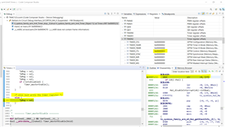

    After Timer_stop() is called, it will eventually write to the timer control register to disable the timer. I single step the disassembly code from Timer_stop() is called until the STR instruction is executed, there are a few instructions to go through. Please look at the callstack below. I counted about 18 instructions before STR is executed. Eventually the TIMER_CTL register bit 0 (TAEN) is cleared to stop the timer. I use Timer2A for this experiment.

    I don't understand this part. What do you mean to add delay? Why is this needed? How is that event generated? What is the priority of that event? Is it possible that that event has higher priority than the task that calls Timer_stop(). In another word, the task which generates the event preempts the task that calls Timer_stop() due to its higher priority?
